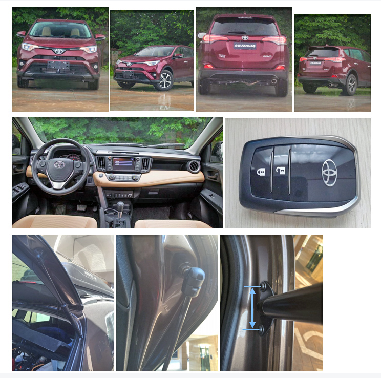

Hi Denis,
Thanks for asking.
We have a kit for 2016 Crosstour, we do not have a kit for old cars.
Could you please take some photos to show your car so that we can check if the current kit can fit or not.
Please refer to this picture - www.che1.com/images/fitness-check.jpg
We need photos to show
• Year of the car
• Car front & rear view
• Dashboard
• Remote keyfob
• Gate pole brackets (top & bottom)
• A clear photo to show gate lock cable connector (optional)
Please also advise if your car has electric lock release?
Best regards,
Tao | Sales Manager

отлично, очень надеюсь что получится установить. ждем отчет.
